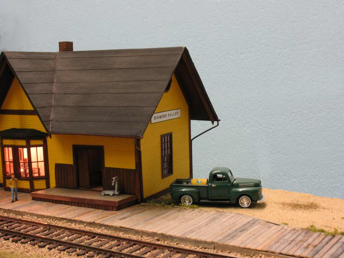

I have a wooden, rail-height platform with my scratch-built depot, but frankly, most small-town, rural depots out this way I’ve seen pictures of, simply used earth. (The station isn’t pictured at its designed location. Its module is in storage.)
Mark
