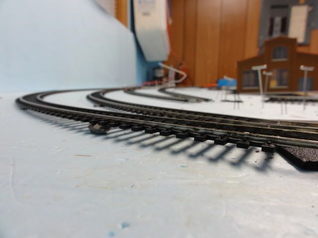

I think the thing to do is figure out the slope and the length of track to go from the roadbed to where it bottoms out. Tack down the end on the road bed and the bottom and then let 'er rip. A 1% slope from a 5 mm high road bed, means a 19.7" run. It might be worth a try on a simple siding to see if it works. It would mean disconnecting the bus at the circuit breaker, connecting a DC power pack to the rails using alligator clips then running a DC locomotive I have along with a couple of cars up and down a few times, if I get Superbe’s post right.

Superbe, do you mean that you lay the track and run trains without anything supporting the track in the transition?

That seems to be what he is saying, at least until the ballast is applied.
That is what I thought he was saying. I might try it on one of my sidings. There is something appealing about letting nature do all the work without having to sand a shim or a styrofoam incline, cut cardboard, fiddle with whatever to get the transition just right.
Superbe, what is a short run as opposed to a long run. I get it about the incline, I am talking, like you, about going from roadbed at 5mm high (WS HO foam) to the layout top.

Going from the roadbed to the layout top is definitelty a short run.

Running the track right off of the cork onto the base is exactly what I did. It forms a natural transition in about eight inches. I ran my trains for a year without any problems before I ballasted. When I ballasted, I stuffed some scraps of folder under the tracks and ballasted right over it. I just used ballast in other areas without the filler but it used too much.
This is what I do too. I like to place a strip of styrene under the tie where the track meets the plywood to extend the slope, since I think the eight inch transition is too steep for my taste. Unfortunately, it does use a lot of ballast, so I have now begun to place cardboard under the track in stairsteps as a means to fill the gap and to use less ballast.
Also, in the areas where there will be a lot of time in between laying the track and ballasting, I use varying dimensions of styrene strips under the ties every two inches to support a lengthy transition until I get around to ballasting over them.

It is said that seeing is believing so here is a video showing a train running on the trainsition without support undernath the track. and the track does not show any bowing or movement
http://s172.photobucket.com/albums/w15/superbe/1-3-2012/?action=view¤t=20120103171222.mp4
