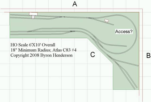

Although you’ve received good advice that it’s generally true that this tight a space is often better-used for an industrial layout, all is not lost if you want to stay with a coal branch theme, even in HO.
If you are willing to put up with tight curves (18" radius), this very rough sketch shows how 9 Atlas # 4 turnouts might build into a little coal branch layout with some possibilities. This sketch shows both a tipple (upper left) and truck dump (upper right), plus a mini-yard and some space for a few industrial tracks. Something like this might be a good way to get your feet wet.
The track curving around to the mines could be gently climbing, a nice way to add interest and to visually separate the mine at the upper left from the town areas below. This woudl also be a good place for you to try some grades on a layout.
It would help those who are trying to help you to know the constraints of the space you’ve shown. Are the top and right side (“A” and “B” in the sketch) solid walls, or open? [I’ve asumed for this sketch that “A” and “B” are walls.] If open, how firm is the angled boundary at “C”? A few small adjustments to the space you’ve shown will allow a broader radius than 18", which will help with reliability and access and allow you to use larger engines and cars. This roughly-sketched layout will require smaller engines and shorter cars for best results.
With just a little more space and some access along “A”, for example, it would be easy to add some staging tracks to add operating interest.
Again, this is just a rough sketch to suggest some ideas along with the more industrial-switching focused suggestions you have already received. Good luck and have fun!
