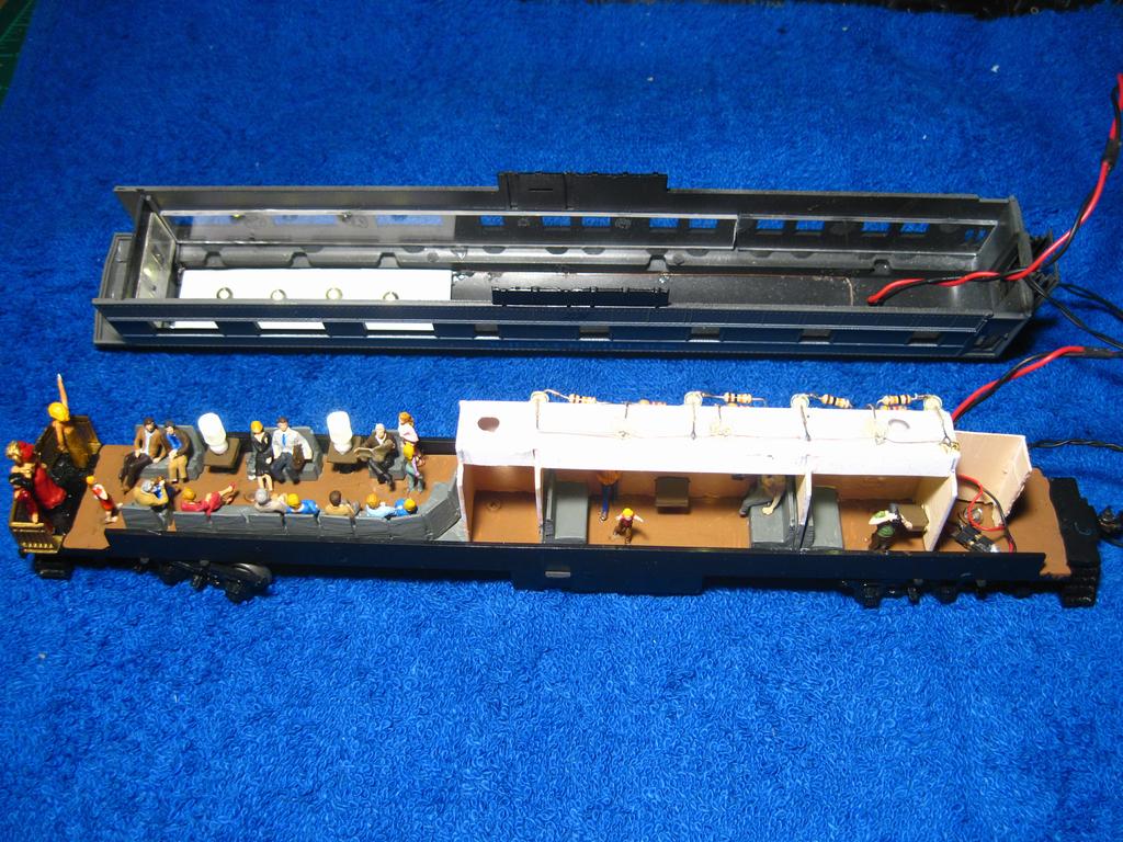

I’m currently working on making 1:87 scale figures for a heavy weight lounge car.
This is an older car finished.
I have about 500 Mel made figures on my model railroad. Don’t expect great results for your first try, like many things casting has a learning curve.
