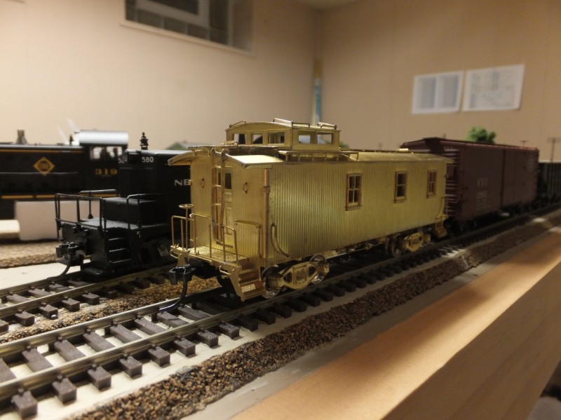

Got the Kadee #58s on 'er:
I had already cut down four (4) brass 0-80 x 1/4" screws to length so I just used those to secure the Kadee coupler box to the underside of the body.
It made its maiden voyage around the layout earlier this evening. Should look really nice once it’s painted and detailed - whenever that will happen.
