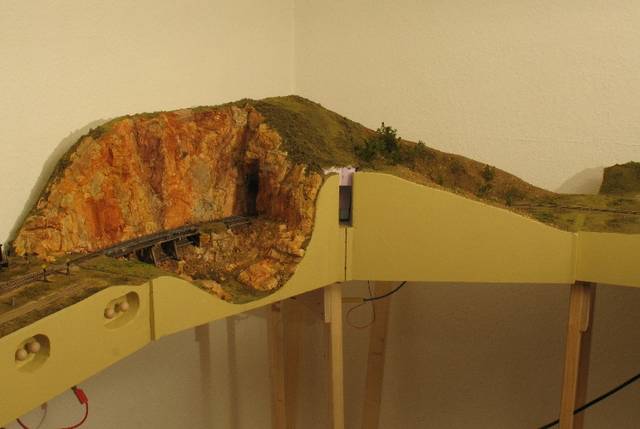

Ok, it’s narrow gauge. Bu I’ve got the idea from the prototype:
and the module with two portals:
Plaster of Paris and Northeastern stripwood. Foam for the base and wood.
Wolfgang
