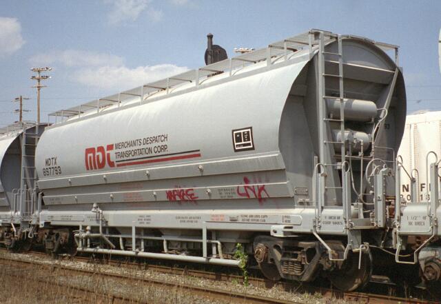

Covered Hopper
http://www.panoramio.com/photo/61642262
Who was it that made a fairly cheap plastic version of this car?
I have a bunch of them that I intended to ‘spruce up’.
PS: Can’t even find a photo of that model freight car, but here is a similar car,
Here is a good photo of a similar car,
