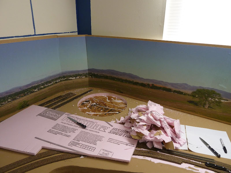

I installed my 130’ turntable over the cork roadbed since my yard was on cork. Just be sure to layout the turntable with the ‘no track’ area located where it won’t interfere with any of your lead or roundhouse tracks (per the instructions). I used a straight track tool to line up the bridge tracks with each approach track. See photos. I love the turntable and it works great.
-Bob
Finally done with the major construction and wiring
