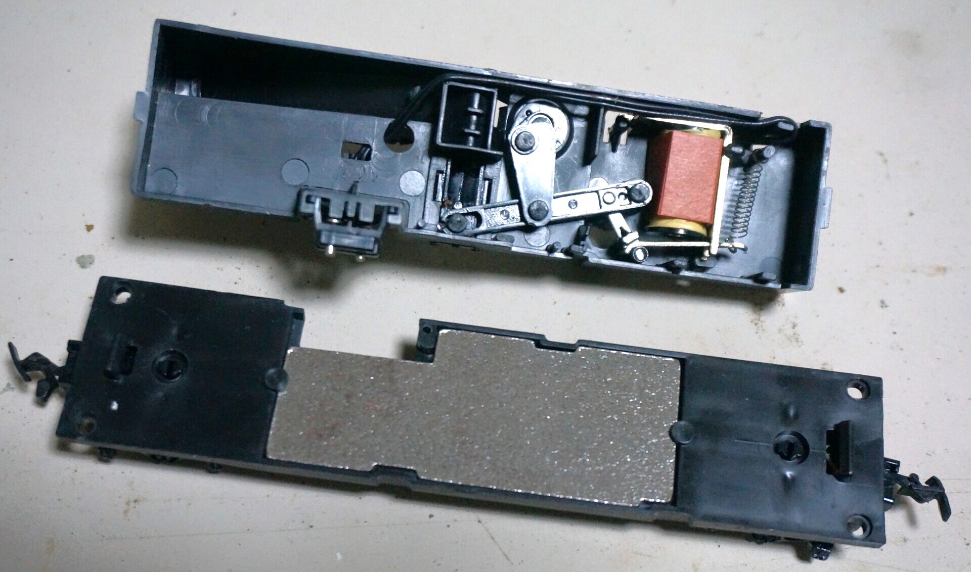

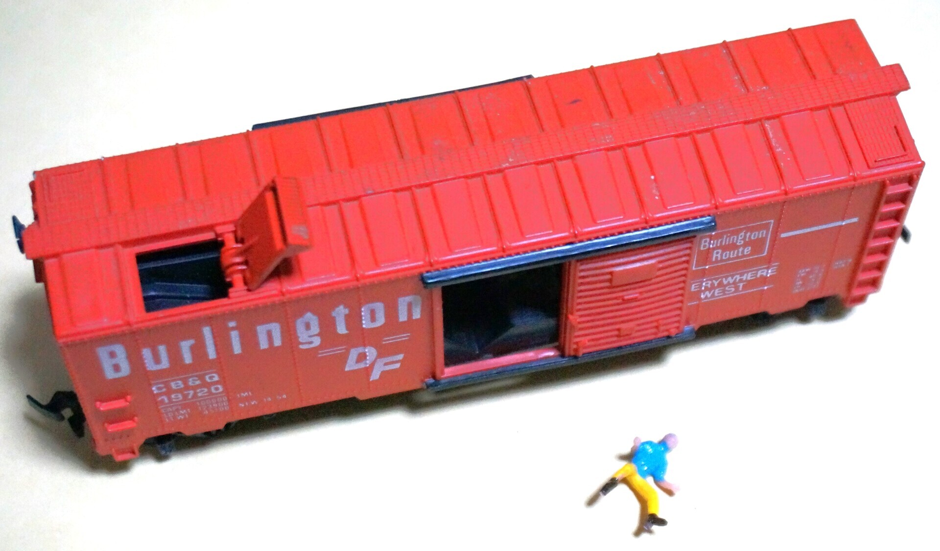

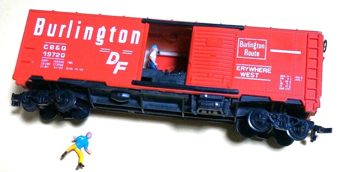

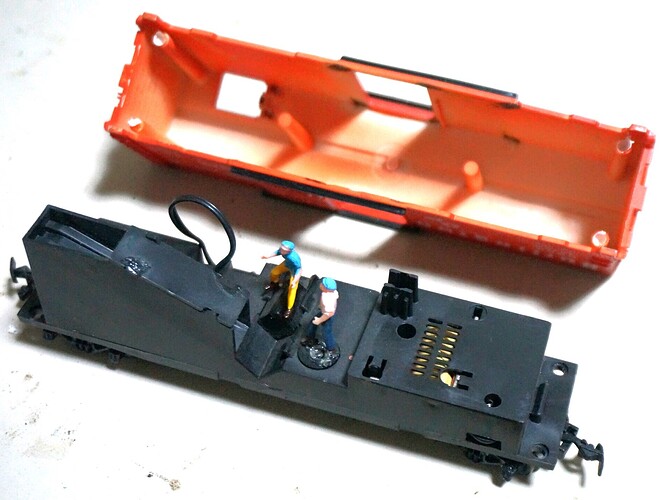

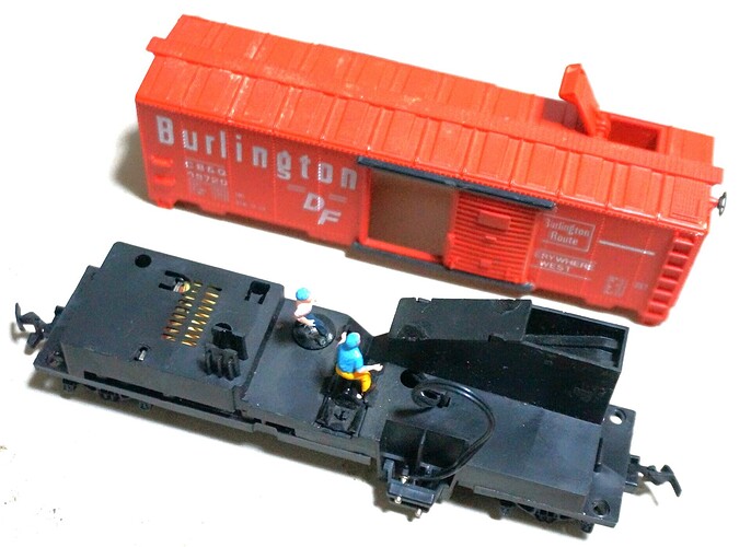

This is a box car that I found among the junk I had taken in. The two figures each have a sliding and rotating movement. I wanted to know how they worked, so I took it apart.
There were several videos on the Internet that explained how they worked.
