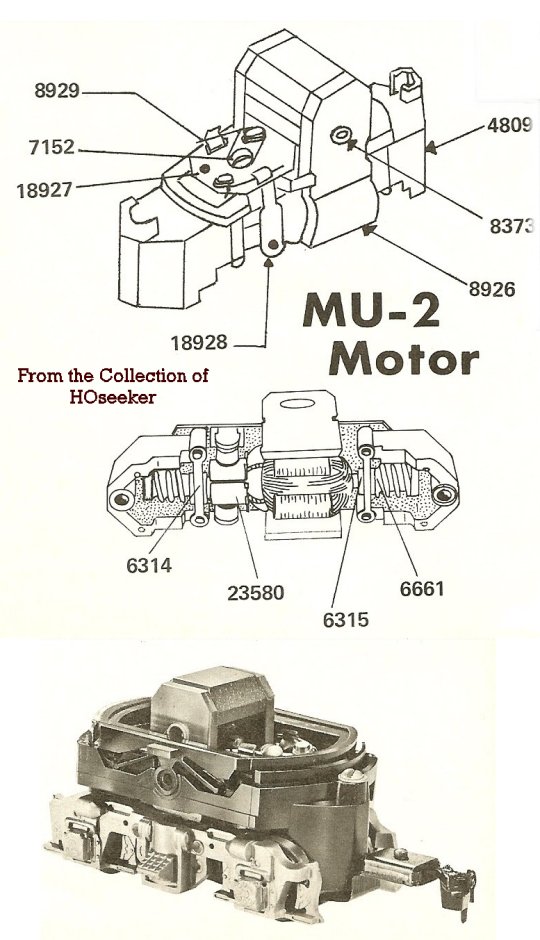

Those Powertorque trucks are weak. It doesn’t take much dirt or old grease to stop them dead, so disassemble the motor and gearing and do a general cleaning and relube sparingly. An alternative is to replace it with the earlier Tyco MU-2 truck, which had a 5 pole motor and was much sturdier. It’s a snap-in fit, and junkers are easy to find.

The Tyco “Silver Streak” C-430 was originally designed with the MU-2 power truck SteamFreak mentioned, so that’s another option. Either way, you’ll probably end up with a donor engine, but you can get them for really cheap (I got my “Silver Streak” for $5, in decent condition).
Outstanding! I did not know about the MU-2 motor, all the Tycos of my youth were the flat pancake style (don’t ask how I know that!). There is a hobby shop locally that has all kinds of stuff, I’m betting he’ll have what I need.
