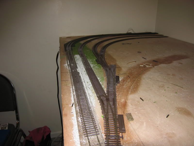

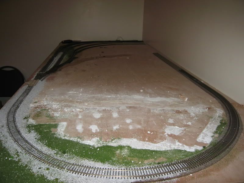

I am calm in making my decision…But I am very excited to get started. I’m tired of looking at all of this material and not having one decent idea so I am gonna post some pics of some track I have laid down but not made permanent and Ideas or criticism is very welcome and needed. I am new to this and I think I have done a lot of research and a lot of gathering in my quest to make an awesome and ultra realistic setup.

I am not happy with this I just laid it down to kind of get an idea or to spark an idea but well nothing happened.Idea?
And this is the whole doorThe whole thing

The harsh reality is, what you have on that door now will get old very quickly!
Ive seen some good switching layouts on that size bench. If theres one tip I’d give, keep the track running away from the edge of your bench. One thing i learnt from a layout of old before it was scrapped, model trains look so much better when they dont run paralell to the bench work edge.
Pluss, those curves will make hands-free, remote uncoulping (adding realism in the process) virtualy impossible. They will also seriously limit the stock you can run.
