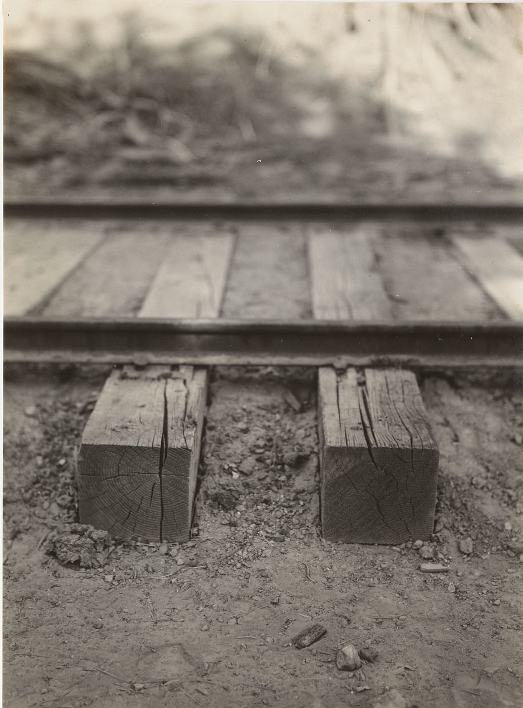

Some of those logging lines laid their track on the ground in such a way that the entire tie was exposed, according to some photos I have seen. Over time I suppose the area between the ties would become filled with debris. To capture that look a very small amount of the “mud” would be used, just enough to cover whatever cork or other product was used as roadbed. Lumber lines tended to be very lightly constructed because the tracks would be pulled up when the area was logged out.

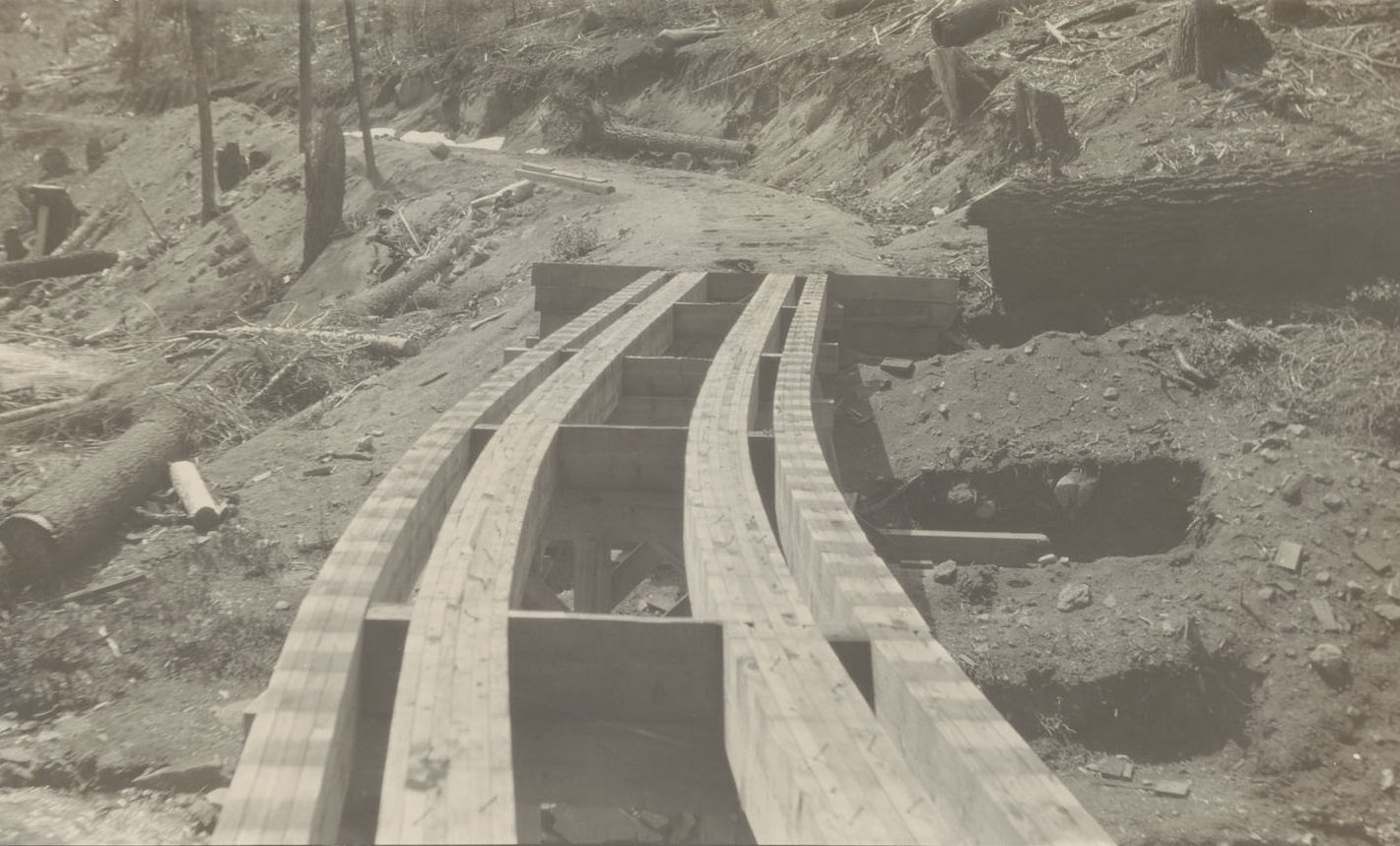

And in certain areas, they simply built on trestles instead of grading.
and dirt
This area has already been logged and the rails pulled up.

Thanks for some excellent photos, I’ll be saving them in my archives. It is felt that they demonstrate what the OP is looking for and they will be an excellent help for what he is looking for,

Thanks for your thoughts the pictures where particularly of value
