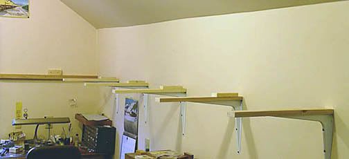

The new layout building styles have replaced the overweight and out of place 2x4 legs, massive L girders, cross braces, risers and joists - geez - Are we building a house or a model railroad? New styles of construction have become the standard since extruded foam board replaced homasote, plywood or boxes of open grid 2 x 2’s with plywood on top. I really like what Bruce Petty of Dunsmuir did and detailed on his website. It’s a system of lightweight brackets that hold small boxes of 1 x 2’s with plywood tops. The boxes rest on a series of extended shelf brackets. This worked great in a 10x11’ room in a new mobile home in Fresno, CA when desgining my new N scale layout. It was lightweight and easy to construct.
Go to his website for more information: http://www.geocities.com/oldlahistory/newshelf.html

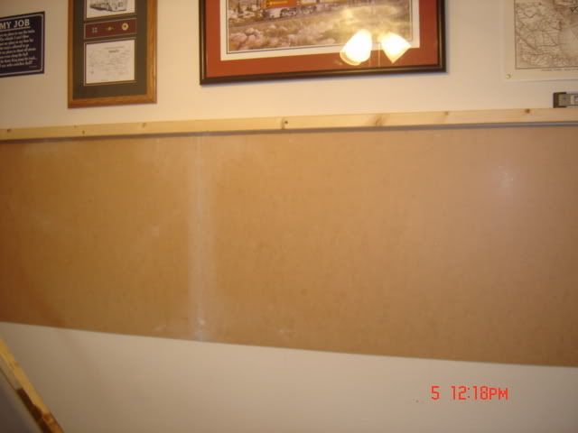

I started with the masonite backdrop panels:

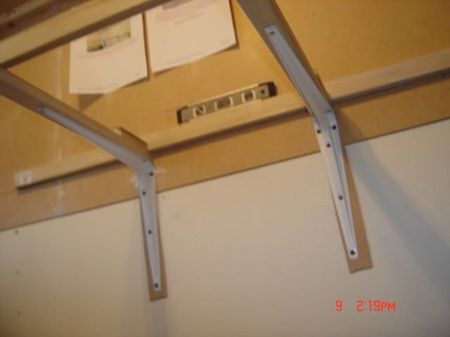

The shelf brackets go pretty fast:

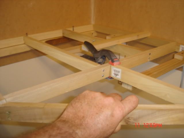

The boxes were an odd shape to fit the plan, I just trimmed everything up and let the fascia do the rest:

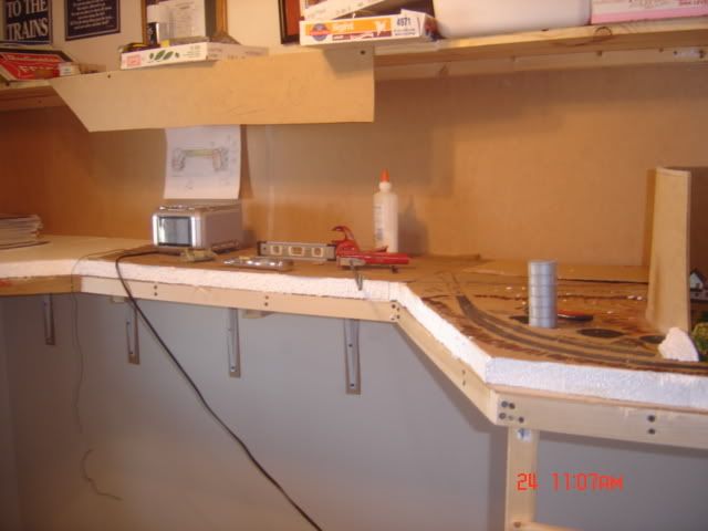

I used masonite to support 2" foam:

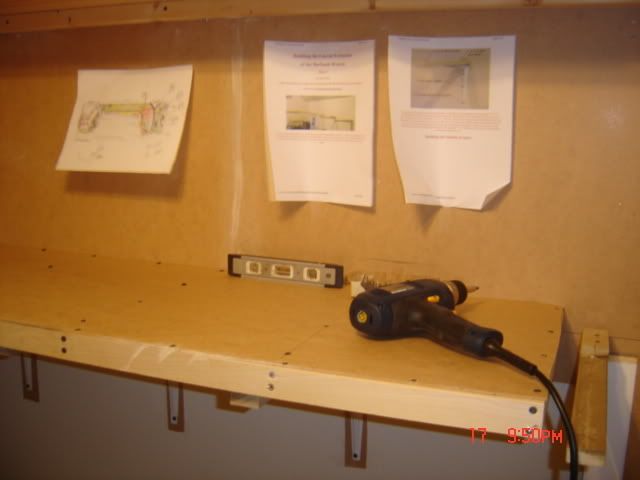

It moves pretty fast, here’s the valance test panel and the layout taking shape:
