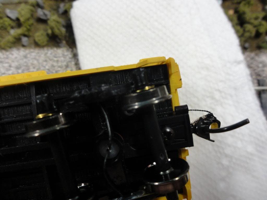

My preference is for magnetic uncoupling using Kadee between the rail delayed action magnets. Why? Because they work, are easy to install and the sight of them doesn’t bother me.
Also I have two cars with remote uncouplers that operate from my Power Cab. Note the wire in picture below. Two cars have a remote located at the brake wheel and the second car has one on both ends.
