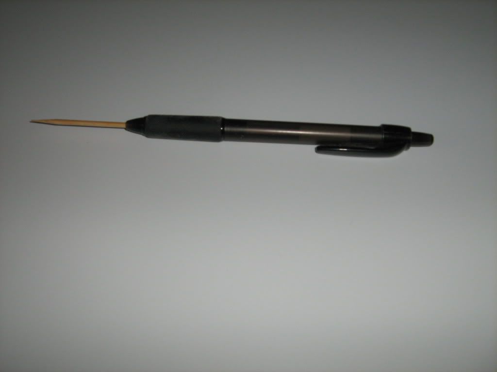

Here is one I use on My I&S N scale layout…
Just stuck it in old ball point pin…Jerry
