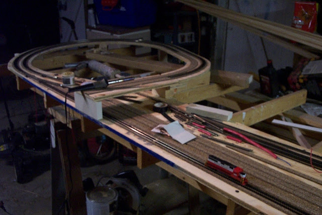

my layout is loosely based on Pelle Soeborg’s book Mountain to Desert expept I have a little more room than he had so I was able to go with 36" radius versus his 33". I am also doing a Canadian theme instead of his UP one. My layout basically goes twice around the room. In the picture I’ve uploaded, you can see the exit from the staging coming up the grade and then again going down.
John

wow John ;love that book and track plan. I can see it in your pict,great job please post progress often Id enjoy following allong ,oops back to topic…Jerry
