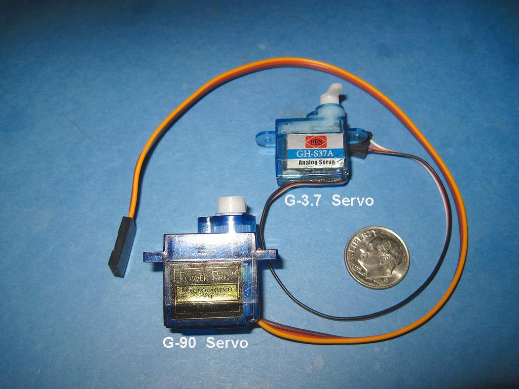

The SG-90 servos ($1.50) only require 1½” hole under the turnout. The higher cost S-3.7 servos ($4) only require a 1” hole.
