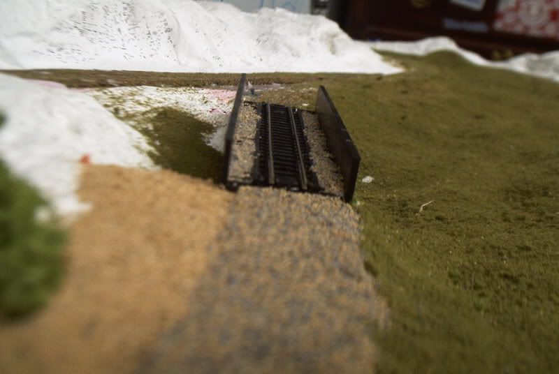

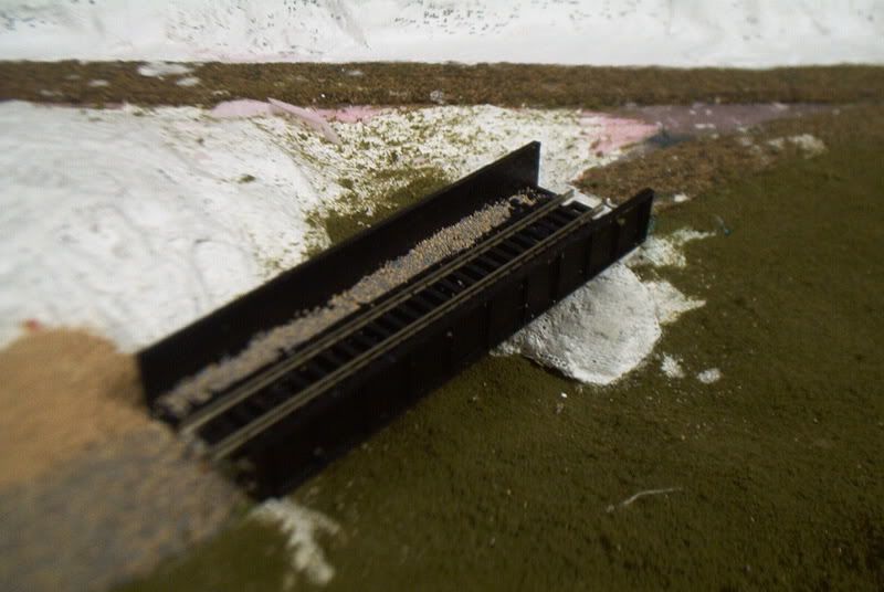

Is an ugly white spot… The bridge is removable as of right now and i cant seem to find what im looking for to go on the area under the rail bridge. Any ideas will be greatly appreciated.

Creek? Dry Creek bed perhaps? Just terrain and a hobo camp? Remnants of a smashed steamer?
I’m sure lots of ideas will pop up here. [yeah]
That just helped me out a great deal.
Now if only i could figure out what to do with that plaster abutment.
Check your PMs. Maybe a bushy/brushy place.
You need some concrete abutments(SP?) under the ends of your bridge. I just bought one of those plate girders yesterday and was wondering if it’s prototypical to have ballast on it or not?
(anyone know?)
I thought the same thing, until i took a ride to see one and sure enough, there is ballast on the edges, such as ive modeled on my girder.
I use sheet styrene to scratch build my abutments and piers.
If you’re not inclined to do that, there are good pier and abutment castings available from Chooch Industries and other manufacturers.

The (former) NYC West Shore has a double track through girder bridge in Esopus and it is fully balasted as is a smaller bridge just to the north of it. There’s your example. go for it!

Can I offer a different perspective. Given the surrounding terrain, It would make far more sense to remove the bridge and replace it with a fill. Real railroads don’t build bridges for scenic enhancement. They build them to go over something that must run underneath it, such as a creek, a road, or even a deep gorge. Given that what you have is just a small hollow, a real railroad would not go to the expense of building a bridge when a fill is cheaper to build and requires little or no maintenance in the future.
Of course it is your railroad and you can make your own rules, but you are asking what could realisitically go under that bridge when realisitically, there wouldn’t be a bridge there.

I was going to say a troll as well but Cp modeller beat me to it.Great little scratch built buildings as well guys [tup]. Here’s another thought to the original question,what about another rail line,you could put a dummy line or one that works underneath depending on the amount of space. I had a similar spot on an old layout and the sceen ddin’t look finished and I didn’t want a water feature so I ran about a foot or so of flex track under the bridge and just sceniced it in .it looked like an old little usd line and I hid it with alot of trees brush etc.

Yeah, an abandoned track. Why didn’t I suggest it?

Not a problem… as I said, your execution looks great! It’s just a little “over-engineered”[:D]
Pull that pier out and throw some weather on that bridge (as you’ve done very well on the plate girder) and you have a top notch scene!
