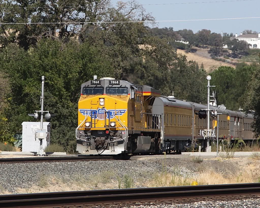

This is the special westbound in Rocklin after checking out the tunnel work. Note the small transmitter antenna on the engineers side of the cab. That transmits the video from the locomotive back to the passenger cars.

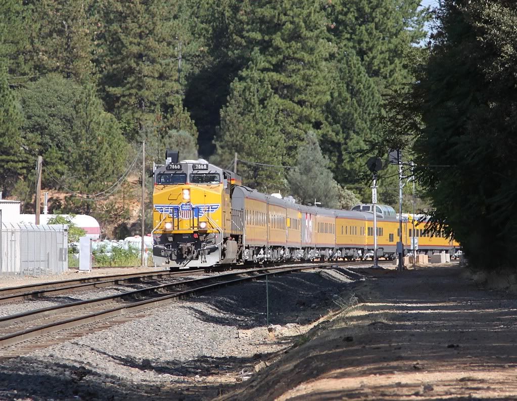

This is the special train in Colfax. You cam spot the new signals masts at the east end of town still turned sideways when the picture was taken in September. The one of the left is just above the cab of the diesel and the one of the right is near the old signal.
