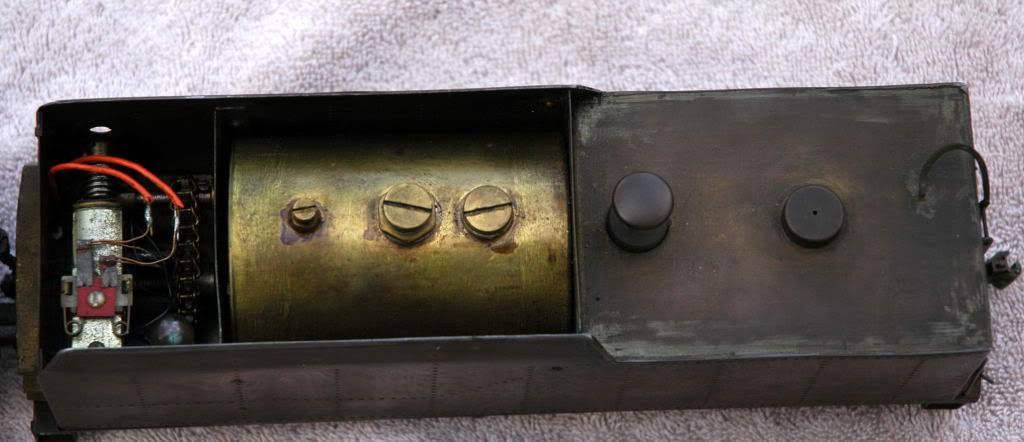

I have recently purchased a lot of trains. In the lot were two Aster trains. A Shay and a JNR Mogul. Those were easy to id as Aster. There was a third engine in the group that I have not been able to id it’s manufacturer. It is a UP 9000. It does have a tender with it. The tender has the water and fuel tanks. There is an electric motor to pump the water to the boiler. The motor looks like an early slot car motor. The fuel tank has a plunger to pressurize the tank.
The tender is made of brass. The engine is made of brass and what appears to be galvanized steel. The engine has been run as evidenced by the oil on everything. The oil seems to have gummed up a bit and I think that everything should be taken apart and cleaned.
The burner does not have wicks. It appears to be a tube with slits cut into it.
I measured the distance between the flanges of the drive wheels and it is 32mm. The drives wheels do have a suspension.
The engine and tender weigh close to 40 pounds
Is there anyone that can point me in a direction to id this engine and get it in operating condition?

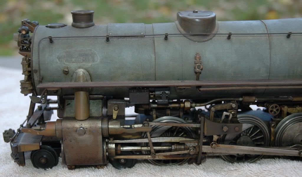

I have seen the engine you have shown. I am thinking that an electric train like the lionel you have shown could have been the starting point for this engine. The castings for the wheels do not match Lionel though. The body work is also different. I think the lionel body is one piece whereas my engine has separate plates bent to cover the boiler. All of the rivets are done by hand as is the detail work.
My engine is definitely not in running condition. The steam oil has gummed up quite a bit and yes the flexible tubes that carry the fuel and water from the tender have deteriorated. Who know what condition the boiler is in.

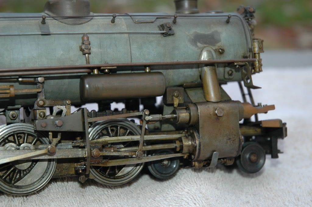

The burner on this engine looks much different from the Aster engines that I also bought with this lot. Instead of wicks there is a tube with slits cut into it. I can see that there are some extensions for the two
control levers that are missing. There is also a lever that I think is to reverse the engines. One of the mechanisms on the cylinders that attaches to that lever is stuck. Other than those items the engine looks complete.

The engine has been positively identified as being scratch built by Rolls Neff. It is one of his later engines. Possibly in the 1970s. Mr. Neff built just over 50 engines in his career spanning 40 years from the 30s to the 70s. He built a variety of engines specifically to fill custom orders. This is probably the only example he made of the famous UP 9000.
I had beenunder the impression that the motor in the tender was to feed water to the boiler. It is actually a throttle! pwer is supplied via the rails and when the motor turns it pushes or pulls a cable connected to the throttle. No need for remote control!

Here are some more photos with a scale included so that you can get an idea of the dimensions.
