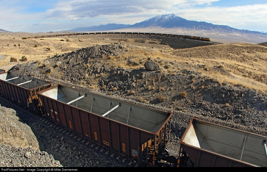

Neat photo from Arnold Loop …
@rdamon - nice link! That must have taken quite a hike and quite a wait to get that pic … looks like rare (for that sub) concrete ties.
