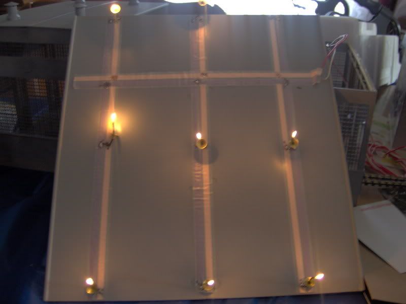

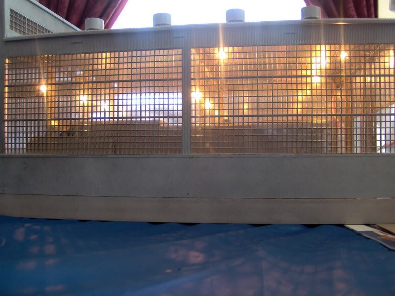

Well I finally installed lights in my Walthers Diesel Shop. after long thinking how I was going to install lights I remembered I had an item that wouldnt be noticable.
What I did was used an item that had been out on the market made by Cir-kit, its called tape wire.
  1. Cut 4 pieces or wire tape to length.
  2. installed 3 pieces runing from front to back of the shop.
  3. Melted the coating ontop of the wire area of tape in 4 places.
  4. Next I put solder on to the bare spots.
  5. The last piece of tape wire I melted the adhesive off of the bottom of tape.
  6. I installed the tape from left to right this acts as the power feeder to the other lines of tape.
  7. I then took the soldering iron and melted the solder where i took off the adhesive and the coating.
  8. I then soldered 12v 1.7mm bulbs by miniatronics which I installed there brass lamp shades over. I used a total of 9 bulbs.
  9. I then soldered feeder wires to the feeder tape wire.
The Photos.

That looks SO real! Great work. What kind of lights did you use?
Glad I could shine some light on this method to everyone. I bought the tape a yr ago and didnt think I would ever use it then I thought hmmmmm I wonder and now I’m going to replace the wiring in the backshop. carshop, and roundhouse with this stuff. Not a soon to be projects tho.
