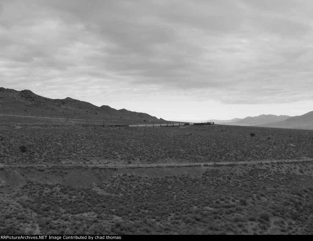

I spent a fair bit of time railfanning at Silver Zone pass when I lived in Nevada. I always wondered about the possibility of building a shorter but steeper second track bypassing some of the big loops and use it for eastbound traffic. I figured the tracks would diverge approximately at the summit, with the ‘bypass’ line staying south of I 80.

Or REbuilding…There was a steeper grade used during the construction before the loop (the required 1% route) was complete. Not entirely south of I-80, but basicly followed the same path. You can see it running north of 80 where the current eastern approach crosses.
