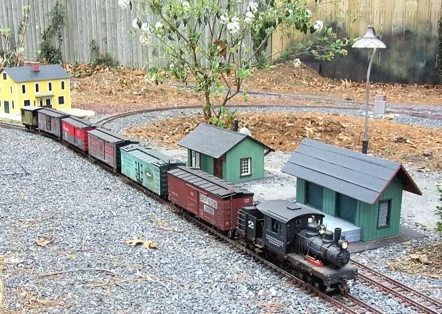

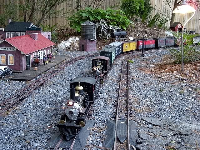

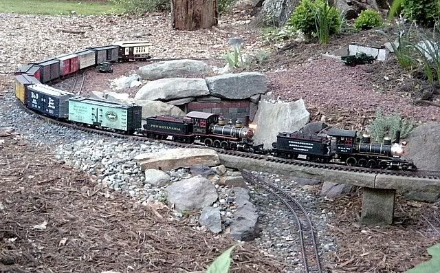

These consists contain a few USA cars mixed in with Bachmann, AristoClassic/Delton, and LGB cars. As you can see they are all pretty much the same size (1:22.5 and 1:24 scale) -
-Brian
The older USA trains (could even be old enough to be called Charles Ro) were essentially the same size as LGB offerings…so roughly 1:22.5. A lot is billed as being 1:24, but very few are…with Delton and the later Aristo-Craft classics being the closest to 1:24.
By mixing and matching a lot of brands over the years, USA size/scale matches very well with LGB, as does most early Bachmann items. Aristo-Craft Classics and Delton are not as good.
So I’d say your USA cars are closest to 1:22.5 scale.
