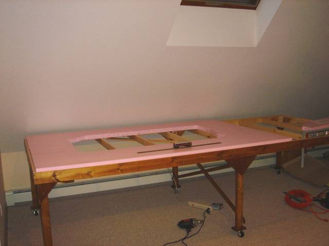

I use pink foam over a wood frame made of 1x4 and 1x3 lumber. (Pink and blue foam is the same, by the way, just a different coloring by different manufacturers.)
That’s an early shot of Phase 1 of my layout, a 5x12 foot table in HO. The foam pictured supports the base of the subway line. The hole in the middle allows for a different level to be added later.
This next picture is much later on. It shows the left-hand side of the top picture. Here, the subway tracks and tunnel walls are in place, supported by foam, and the rest of the layout is built on top of a second foam layer.
The roundhouse and turntable are on that different level of foam which is simply an open space in the first picture. Finally, for the next picture I’ve replaced all the liftoff sections which allow access to the subway tracks below.
The liftoff sections themselves are mostly made of foam, too. It’s a great material for this. It’s light, cuts and shapes easily, yet it’s stiff and holds its shape. It holds glue, plaster cloth and Gypsolite, too.
Having built Phase 1 of my layout with this foam-over-wood-frame construction, I’ve now built the benchwork for Phase 2 the same way. It’s certainly worked for me.
