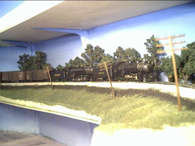

Find 1/2" thick foam and use that as your subroadbed. Add HO cork on top of that (three strips wide) and N scale cork on top of THAT (three strips wide). I just did this as a test for my new layout (central Illinois, where the roadbed generally looms high over the surrounding terrain) and it works great. I don’t have any photos of my test (yet), but here are a few of my last layout, where I was adding 1/2" foam and HO cork, which worked equally as well.
The trick with the 1/2" foam is to cut it into strips and add it to the layout like cork. I used a 1x2 as a cutting guide and quickly ripped a 4’x8’ sheet into 1-3/4" wide strips of 1/2" thick foam, and then added the material three strips wide along my center lines (a 4x8 sheet of foam will give you 72 linear feet of roadbed). Once the foam’s down, it’s easy enough to cut it to shape with a SHARP snap-bladed boxcutter.
How about the N cork on top of the HO cork? That way the top width isnt too wide and you get the height you want. A little bit of sanding should finish the profile. Heck…if that isnt high enough, put the N cork on the HO cork then put that on O cork…and so on…and so on…

Ray, that roadbed looks great! Definitely along the line I am looking for although maybe not quite so high. Finding 1/2" foam has been a problem though… I wanted some for other uses too. I found the stuff Chuck recommended but not in an affordable package. I like the idea of using foam to contour roadbed as well as bases for some scenic elements, but the 2" stuff is just too thick.
