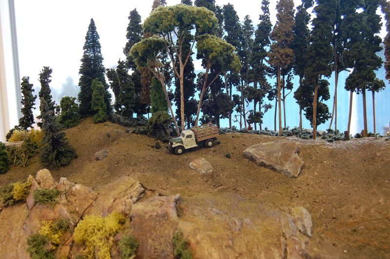

I use real dirt on my layout a lot because this part of Alabama has a characteristic red soil that’s almost impossible to duplicate. I just dig it up from the back yard, sift it, microwave to kill the critters [:)] and then use it on the layout. I put it down as a base cover since everything else grows out of it. I think it would make a heck of a mess if I used it on top of fake fur. My dirt will also darken up due to the soaking and glue but I’ve found a light spray coat of red primer brings it back to just about its original color.
I used real garden soil for the yard, but I screened it first with a section of panty hose, and then mixed plaster of paris in with it to make it harder. I also sterilized it with alcohol as part of the setting and drying time when I prewet it before pouring the glue mixture over it all. Makes a fairly robust surface, and the bugs, if there are any, won’t be able to surface/emerge.

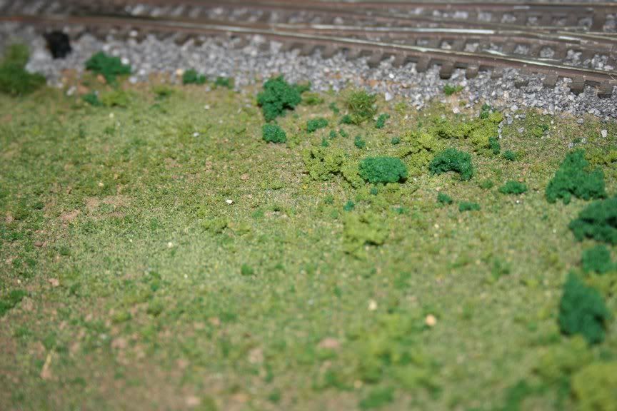

The above picture, I sprinkled real dirt on ground goup. I then sprinkled areas with ground foam to vary the color. I have found that white glue does not darken as much as wood glue.

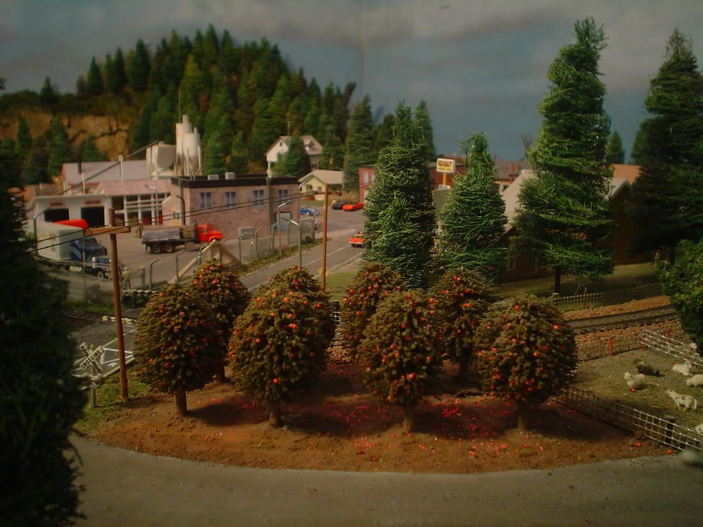

Hi, I also have used real dirt on some places on my layout, I used it in the apple orchard as you can see in the pic below.
I found a place last summer where the cattle had beed rolling and was very fine, like baby powder, I sifted it through a tea strainer to remove any rocks, and put it in the area where the orchard was to be, wet it with wet water then soaked it with a glue/water mixture, then added the trees. It looked wet like after a rain for a few months then turned back to the color it was to start with, I have seen no sign of any critters. If there were any in the dirt, they are now intomed into a perminate place. Hope to be of some help. Mike
