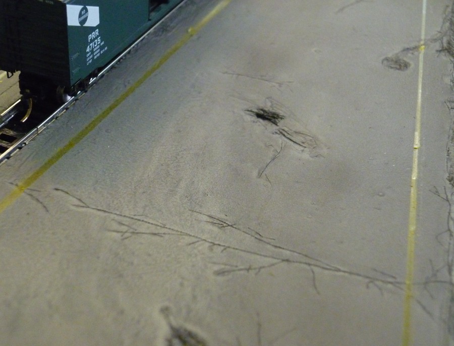

I’ve used sanded grout, foam adhesive caulk and carpenters glue. http://www.trainboard.com/railimages/data/500/O_Brien_-_Lumber_Yard_Worn_Asphalt.jpg

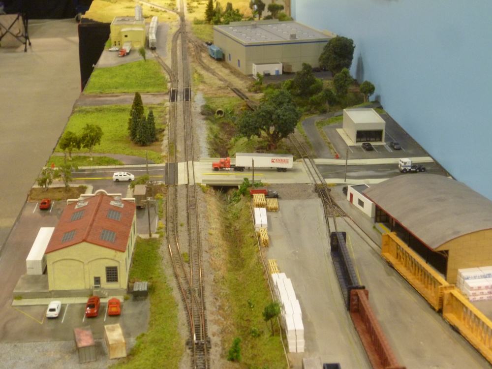

I’m in the process of adding styrene roads to our layout. The roads used to be AMI instant roadbed, but that was just took thick.
Now I’m using thin 0.010 styrene sheets for the roads. To secure them to our plywood base, I’m using Aleene’s Original Tacky Glue. Thin, dries clear, and I believe it will enable my roads to be removable if I ever need to move things around.
Here are some of the styrene roads I’ve installed:
All these roads and parking lots done in styrene
