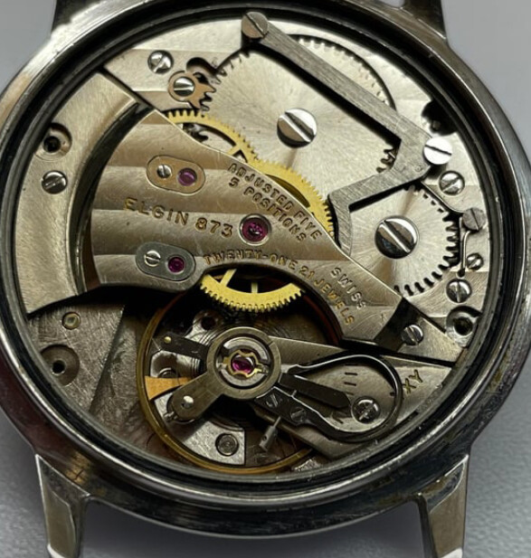

It took a little work, but I found a picture of the A. Schildt 873 movement that replaced the 730A/780 after Elgin abandoned domestic production in 1964:
I believe this is the same 1604B that was in the early Ball Trainmasters.
