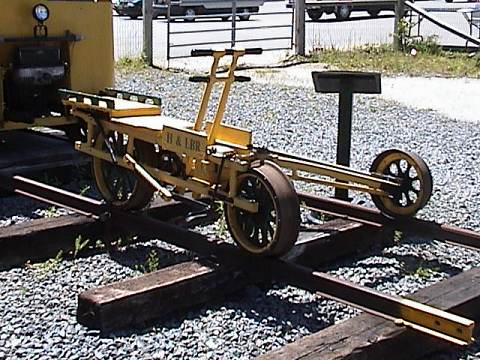

Has anyone built a motorized version of these?
The only one I’ve seen was human powered, near the Hi-Line area in Northern Montana along with about a dozen speeders.
that’s what I meant, human powered, but a model with a motor, that has a figure pumping it to make it more, although it is motor powered under neath the hood…I could also have it DCC, and have a Z scale decoder, so that it is well hidden…

Just guessing, probably about 1-1/2 feet tall, I will have to go out and measure it later. To give you an idea of the relative size, look carefully at the mounting flanges on the crankcase. The lower flange that is mounted to the board would attach to the top of the lower frame member of the velocipede. Now note that there is an upper flange a few inches above it… that attaches to the underside of the upper frame member. So, if you look at your original picture, the engine would be directly behind the front wheel, with the mounting flanges on the insides of the upper and lower frame members just in front of the pump handle. I’m guessing that the motorized version was slightly longer to accomodate the engine. The cylinder stuck up directly behind the front wheel. There was a roller chain drive from a small sprocket on the engine to a large sprocket on the front wheel - no clutch, no reverse, no multiple speeds. The engine has a compression release so the rider could get the velocipede rolling to start the engine.
