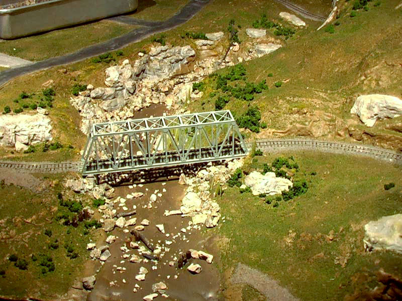

I’ve found a similar issue on my hexagon layout.
After applying the rocks from the molds, and adding some finish plaster to eliminate the finger furrows and such, there’s still some weird areas in between rocks and on the sides.
Since I was working over a particular chunk of rock in a bend in a river bank, here’s what I did. (See the picture below for a reference to the area involved.)
First, I placed some big chunks of talus at the bottom. In a freeze-thaw cycle, rock will always break off and pile up. Also, in this case, I have a stream that would be wearing away any underlying layer of rock, so overhangs will eventually crack and fall.
Second, I used progressively smaller pieces of talus, either right below the cliff or rolled down from on high. In fact, most of the rock you see in the middle of the stream bed ended up there from the rolling. A lot also filled in the gaps. (In the photo, the area I’m describing is what you see upstream of the bridge.)
Third, I used some Hob-E-Tac adhesive from Woodland Scenics on the vertical sections that got painted in earth tones, or that were clearly too smooth to qualify as real rock. (One example of this kind of vertical face is seen next to the tracks on the right side of the picture; another is almost directly above the right half of the bridge, there’s a brown-painted section between some rocks.) This adhesive comes with a brush, and it stays put, since it is pretty thick. You have to let it sit for about ten minutes before it is tacky enough to really hold stuff well; the directions indicate that it will start turning clear at that time.
Fourth, I used some of the Foliage from Woodland Scenics. This stuff is like colored hair with bits of ground foam on it, and you pull it out and keep tugging at it until it is as diaphonous as you want. I was generally pulling in only one direction so I could get the long, clinging
