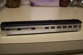

You might remember this car below from my thread 2 years back. It’s a 1970s AHM Pullman Standard Amtrak Blunt-ended Observation car that I stripped down, added fluting, and metalized. I’m going to use it as a “Foobie” observation car for my version of SCL’s Champion. (Foobie being that it’s my “Wannabe” Budd since no one makes a decent plastic 85ft. Budd Blunt end obs-car)
Originally I was going to sell my older cars but with today’s prices for new cars, I’ve decided to keep and upgrade them; especially since I have a lot of spare parts on hand. I’m taking DCFixer’s suggestion and will upgrade the windows on the AHM units.
