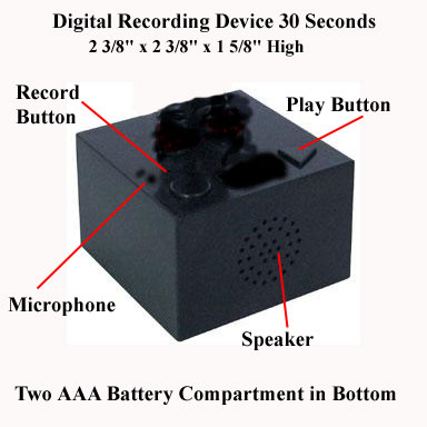

How about exactly what you’re asking for for 8 dollars?
http://www.bakatronics.com/shop/item.aspx?itemid=690
I’ve bought stuff from these guys, and they’re legit.
All Electronics sells that same device for only $2 each. http://www.allelectronics.com Catalog number SAW-3.
