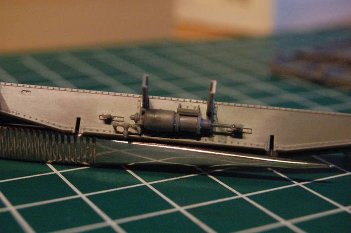

Anyway, here’s a some shots of the progress… I got as far as “OK, put everything down and let the glue dry”. Figured the directions said that for a reason. These arent all the pics I have, they’re just the two that are best focused (I’ve determined that the Manual setting on my camera is much better at picture taking… now I just have to learn how to use it[:-^] but I digress)
This is the (upside down) flatcar bed, showing the stake pocket detail (good thing I had the foresight to get an optivisor as well… those were SMALL!)
This is a shot of the beginnings of the underbody/brake system. (again, very glad I got the optivisor, some of the piping detail was seperate parts)

On the pictures. Since you are using manual mode, Dan, you may want to use the tripod you bought to steady your shot. My guess is that the blurring is from the shutter being open for a longer time. Your 2nd pictured turned out better.
