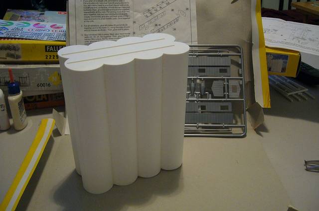

One thing to keep in mind is that the cylinders in the Walthers kit overlap each other. If you add more silos with PVC, those cylinders won’t overlap unless you slice the sides off with a table or band saw.
In the pic below, you can see how they overlap.
