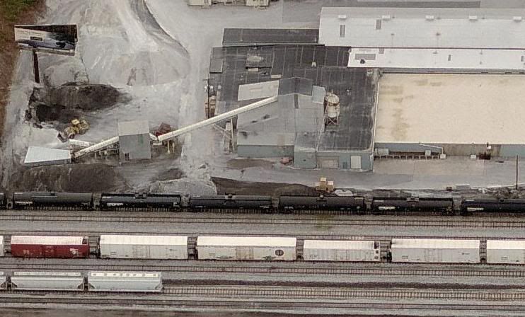

How about an image of a prototypical model?

Hey D. Griffin, Nice photo, but how do they get the gravel out of the tank cars when they are unloaded? :slight_smile: Ken

Ahhhh that’s $1,000,000 question isn’t it.
Such companies were placed close to gravel pits where it was dug up. These are brought in on trucks and “dumped” The shipment is then presorted, and dumped into a receving bin, by a front loader/tractor. What type of gravel that went into the receiving bin was based on what composition they needed that day.
What I pictured above is actually part of a cinder block/brick factory. But the process is the same as a gravel company. Hence why the buildings look so similar. The only difference here is that finished cinder block gets loaded onto the train. It could be a good kitbash for a lil variety! I’m going to attempt to model this area using LDE’s principles with my second “Lunch Hour Model” series.
Brick/Cinder block and concrete companies would often vary mixtures of aggregate (stone/sand/binding compounds/additives (ie:lime)) based on their production orders for the day. So you could have several different pre-sorted piles of raw material.
Walthers Glacier Gravel kind of does both receiving and shipping by train. You dump coarse, irregular, unsorted gravel via hopper car. It gets pulled up into the building, sorted, sifted, and mixed based on needs. The resultant goods were distributed back into another hopper.
A coal mine sifter/screener works on a similar principle.
