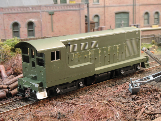

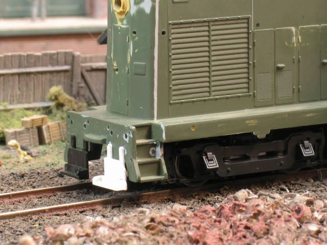

I’ve just made a start on a Walthers H10-44.

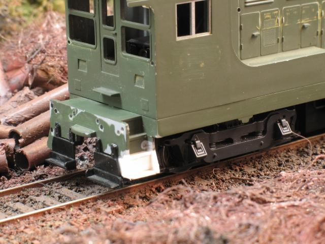

There were a couple of bits missing when I was given it, notably the rear steps - looks like it was dropped at some stage.
I’ve now rebuilt the side steps and the rear platform, as well as removing the CN markings with a fibreglass pen, so I can now start adding a few details before painting.
I will leave off the handrails and any grabirons until after it has been painted and decalled, although I’m still not 100% sure what it will be painted into.

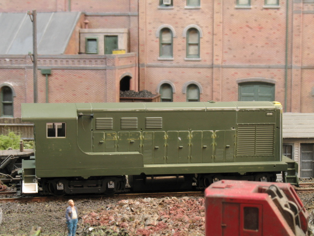

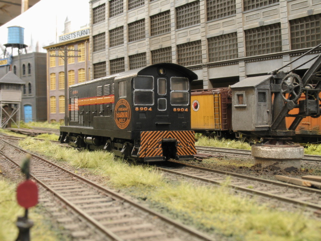

Paint and decals applied. I want to dullcoat the loco before making a start on the handrails.
Jon
Nice looking locomotive you got there Jon. Are you going to put sound in this model?
-Smoke
Yes indeed, but it hasn’t arrived yet. It’ll be Soundtraxx generic FM
There’s plenty of room inside after removing the long weight above the motor, so I’m gonna try a big speaker.
Jon
Very nice Jon. That’s a handsome paint job for that little locomotive, and you’ve certanly done a good job modeling it.
Noah
Wow, that was fast! Good looking paint and decals, especially on the footboards. I’m looking forward to seeing it with the handrails on.
SWEEEEEEET looking locomotive, man!!! I am jealous. Nice paint job. Shows what a little elbow grease can get ya…
Brian

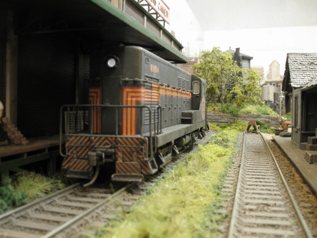

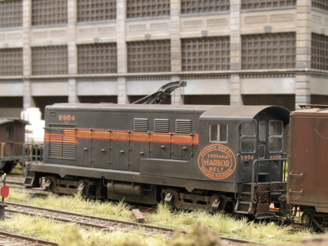

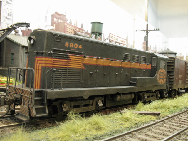

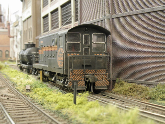

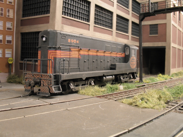

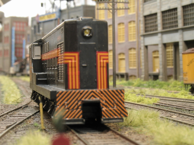

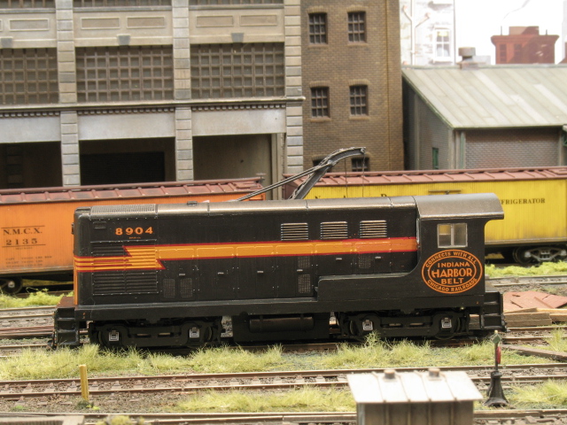

I finished the model tonight, fitting the handrails, shade for the light, and adding a bit of weathering. I ended up using the original handrails for the pilot and they’ll do for now until I can pick up some better ones.
I still have to get a FM soundchip before I consider it finished and ready for action.
Jon
A beautiful and inspring job of modeling. I just got one of these in Santa Fe Livery on E bay. Can you tell us what you used for the replacement handrails? Many thanks!
