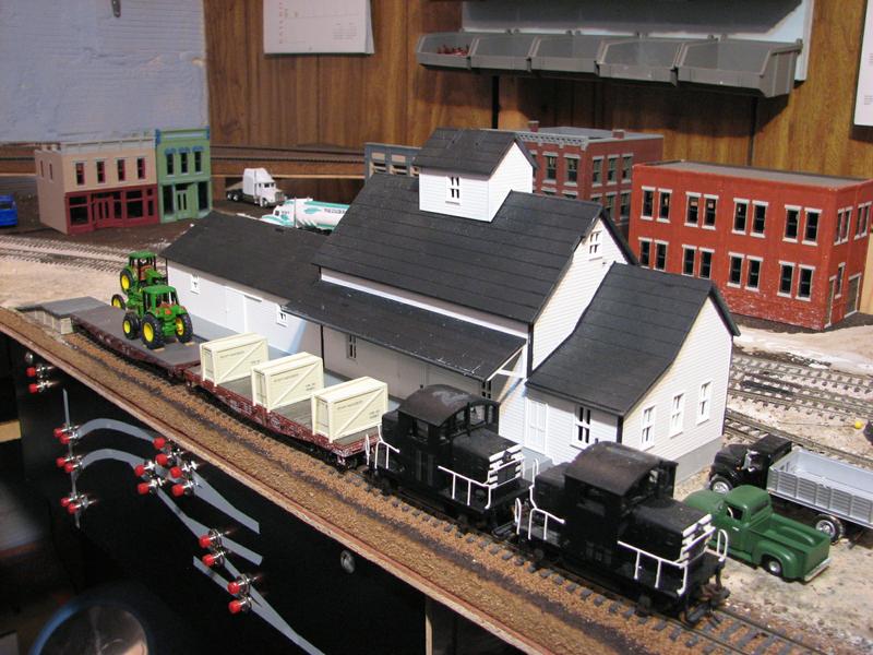

One thing I did was replace the short loading dock with a longer one. Right now, I’m just trying to get buildings on the layout. Once I get it reasonbly well populated, I will ogo back and add details.
The best way to make it not look like a plastic kit is to paint and weather it.
Here’s mine in N scale as a combination feed/fuel dealer:
I left off some of the roof doo-dads and and part of the shed.
This storage building is the only plastic kit on my layout. Once the paint had dried thoroughly, I weathered the roof with Polly Scale dust and the walls of the building with diluted India ink. I’m pleased with how it turned out.
The way the kit is built in two separate structures gives you some pretty good kitbashing opprtunities. You could build in an L shap or even split up the two structures so one is on either side of the rack. The one thing I din’t like about the kit was that it doesn’t give you the option to have any of the sliding doors open. If I was building another one, I’d attack it with my Dremel tool and get some of the doors open. Extending the loading dock is also a good idea if you are using the dock side toward the track.
How you piant it and weather it will make all the difference in terms of it lookling like a plastic kit. I painted mine mineral red and then distressed it with a small wire brush to give it the “used but not condemned” look. Here’s a photo. I think it looks pretty much like wood:
