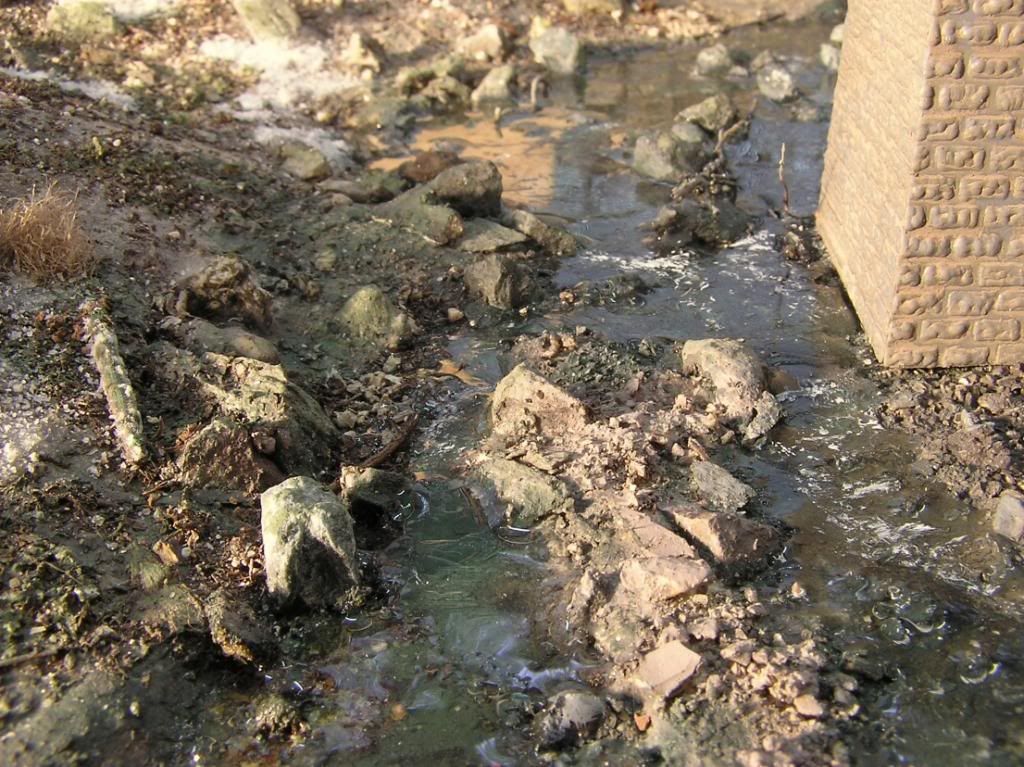

When I made my rocky river I mostly glued down everything - rocks, gravel, logs - before pouring the water. It meant I had to spend a lot of time teasing out the water’s edge with a toothpick and guiding it around the rocks. It was very time consuming but I still feel it’s the best way to go. I used real rocks, and I painted them to suit the surrounding landscape.
I did insert a few bigger flat-bottomed rocks into the wet resin and they worked well too. You just have to be very careful there’s no dust or grit on them because it’s a sure bet that it’ll fall off and land where you don’t want it.
If water rides up the sides of the rocks you can disguise it with paint. A fiddly but worthwhile job.
A little bit of off-white paint can represent suds and help it to look as if it’s flowing.
This pic shows how much work I did to it before pouring the resin:
and after pouring the water and adding some off-white after it had dried…
