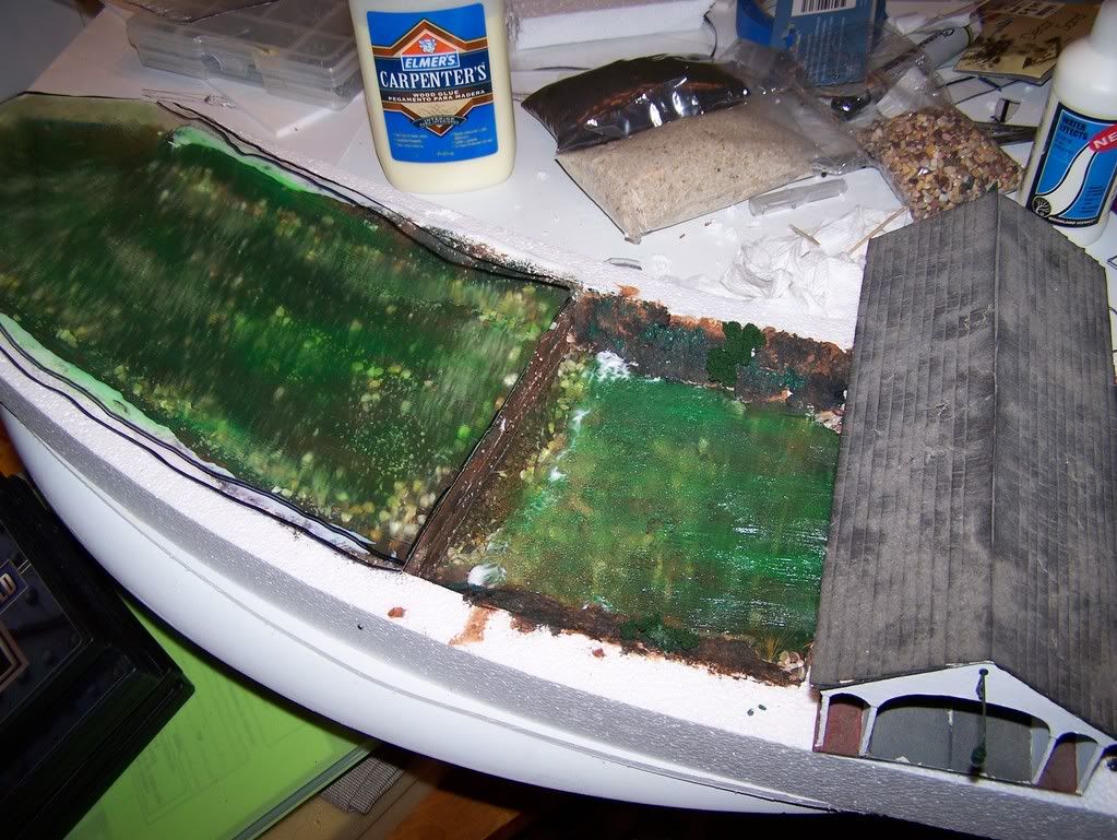

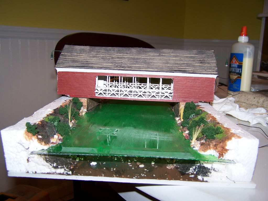

Besides two cascading rivers constructed with Magic Water, I have two fairly large harbors. For these I used several sheets of translucent plastic with varigated patterns, (that are used in doors, and suspended ceilings). I painted the plastic base with appropriate dark bluish green. This is a cheap way to make large harbor areas. Bob Hahn Click on the photo to enlarge it, then click on the photo series at the left to see the rest of my layout.
This may keep cost down. I applioed WS water effects over the clear acrylic.

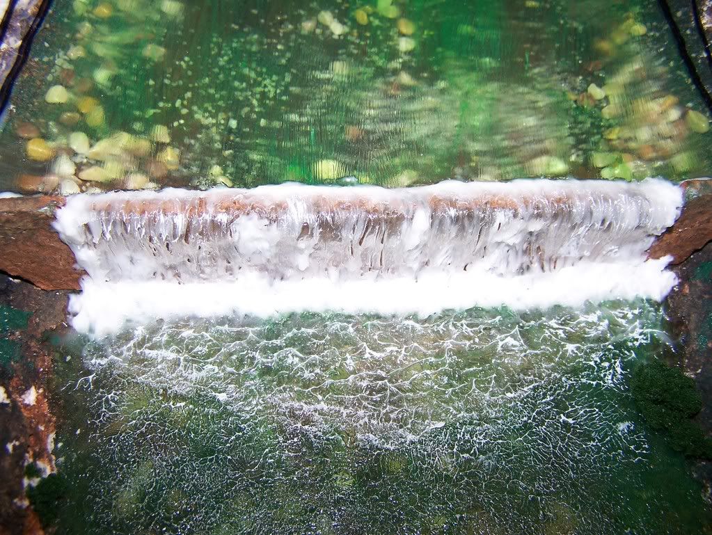

I’ve used the ws stuff and really didn’t care for the results then when I put in the new river this year I used envirotex and loved the results and then went over the ws area waterfall and small river with envirotex , what a differnce.
