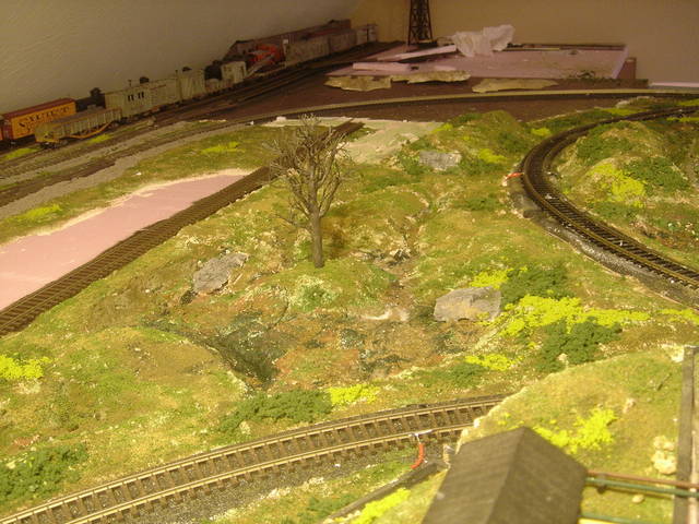

I took lots of pictures as I built a swamp on my layout. First, I identified a large, flat area. I use pink foam as a base. I cut into the foam, and gouged out the rough parts you see. The parts that are flat will be above the water level. I added some elevation with scraps of foam, and this picture has some loosely-placed rock castings, too.
The base of dug-out foam is pretty rough, so I use plaster cloth to smooth it all out.

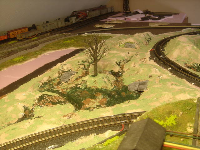

Next, I use a thin slurry-coat of Gypsolite, a gritty plaster, to coat the terrain. I do the same thing for the base of ponds and normal above-ground layers. Gypsolite is naturally gray, so I add some brown craft paint. It gets lighter as it dries, or maybe I didn’t have enough and the plaster cloth is showing through. Here, I’ve started to paint the deep parts with black acrylic craft paint.
I use washes of different shades of green and brown to give variety to the swamp basin and the surrounding land.
Almost ready for water. I’ve still got some bright spots, which need to be touched up with paint. Once you start pouring the water, you won’t be able to get under it, so make sure every bit of bright white plaster cloth is painted or you’ll hate that spot forever.
I use multiple pours of Envirotex LIte for my water. I tint the lowest layer darker than the rest. Here, I used brown to get a very
