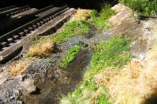

I used patching plaster over plywood, painted with latex house paint, followed by three coats of high gloss water-based urethane.
Easy to do, easy to clean, and very durable: I often place the camera directly on the “water” to take photos.

I like that first picture of the stream.

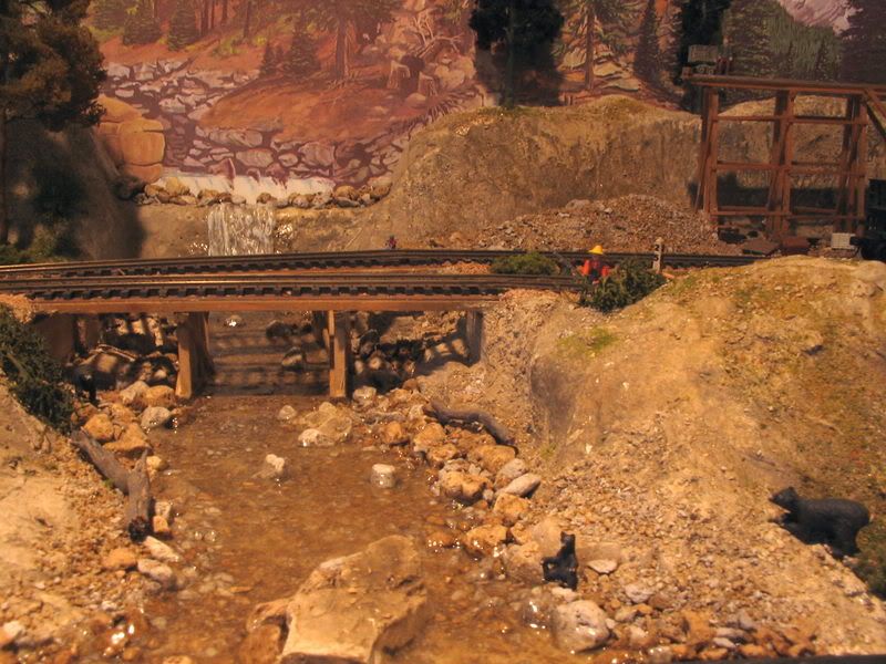

Another rocky riverbed picture … I like seeing all of the rocks and talus in the bed …
I think I should have put bigger foundations on the bents, as the water runs right up to the edges.
