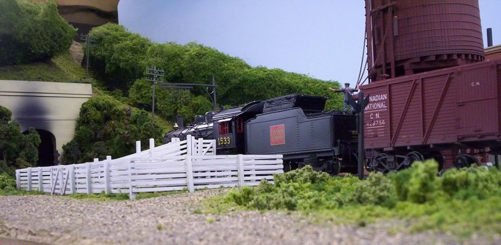

Well, mine aren’t motorised and not equipped with sound either, and, even worse, some of them are the old Atlas versions. [:$] However, an operating spout does provide a nice photo op:
For the same reason, the coal chutes and sand spouts on my coaling towers are moveable:
LPBs and vehicles can be moved about the layout as required, and I build many of the vehicles with removeable bodies - this allows them to be parked empty, or on a road with a driver (maybe passengers, too). I’m not a big fan of animation (other than the trains, of course) on my layout, but being able to change otherwise static details can help to keep the layout from becoming visually stale. For the same reason, I use “live” loads in my open freight cars and in the coal bunkers of the steam locos, too.
