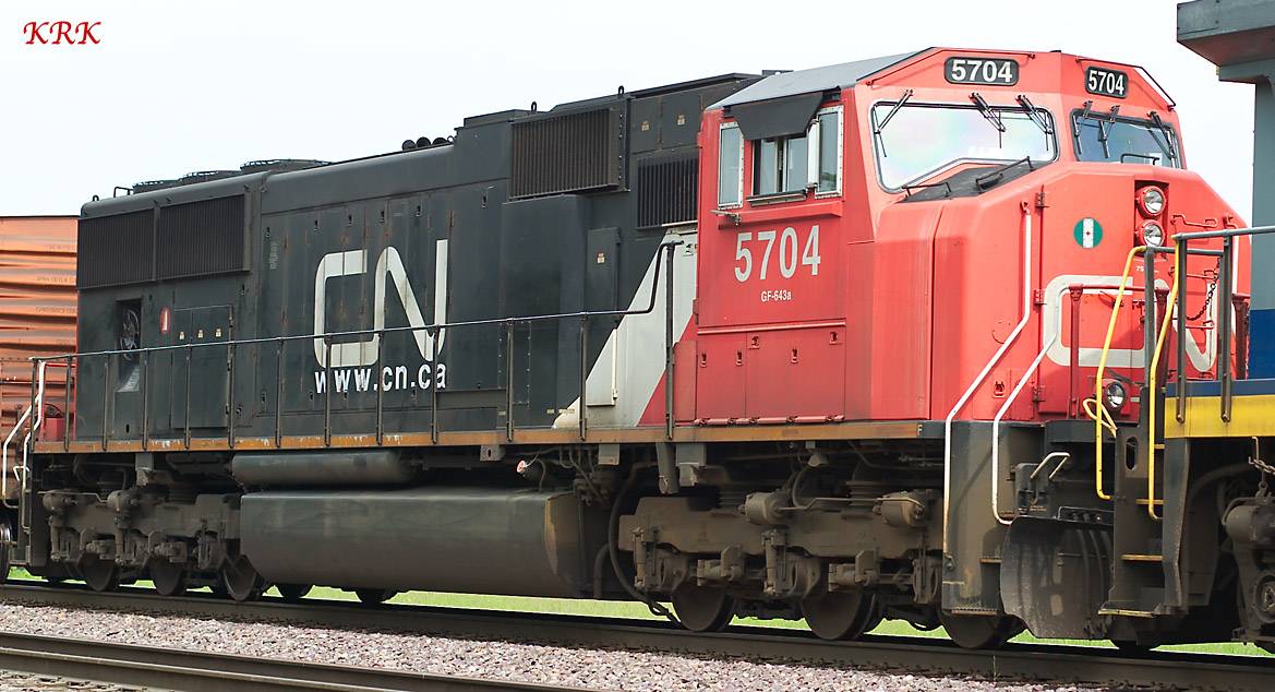

Great story about the cat! I’m having trouble picturing where he was, though. Can someone shed some light on this?
It’s been a while, but I seem to recall looking up that train at the time, and the second (dead) unit was a EMD SD75I.
I suspect the cat had been hiding on top of the fuel tank, in behind the air reservoir. As this is directly underneath the engine that area would still be fairly warm and sheltered in the winter. There may also be holes in the frame large enough for a cat to climb through into the engine compartment.
