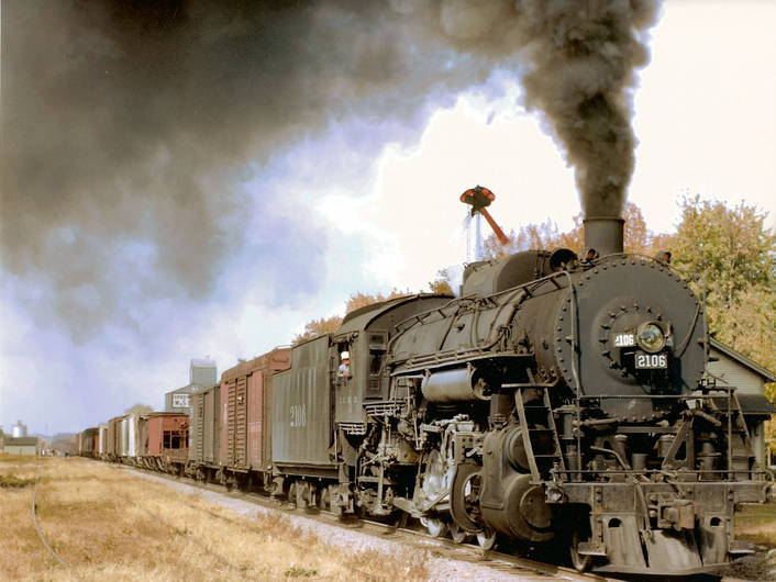

When in doubt work from the prototype:

Orsonroy, thanks for the PIC I have saved them and around say 70 others.
