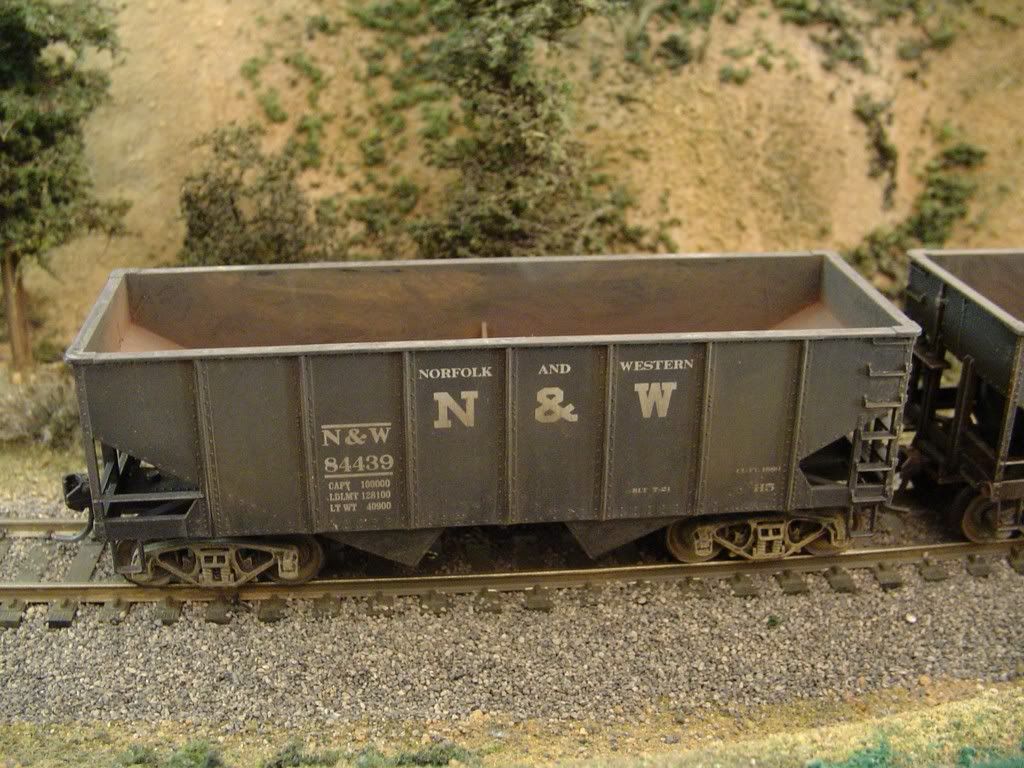

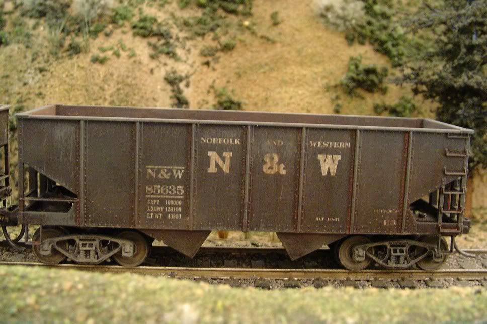

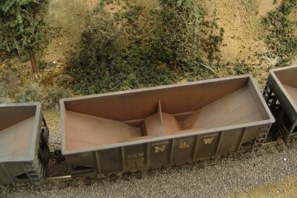

I’m just finishing a batch of hoppers for a friend and thought I’d post pictures of them here for comment, criticism, and whatever value anyone might find in the pictures as examples. Besides, I think I have finally mastered the mechanics of posting photos to this forum and want to demonstrate it (to myself).
First, some general comments: All of the cars in this post are custom painted USRA 55 ton hoppers from Accurail. They’ve had Kadee couplers and Intermountain and Proto 2000 wheel sets (with 10K resistors) added.
All of the weathering was done with Bragdon Enterprises’ Weather System powders. A couple of cars were sprayed with Krylon Matte Finish before weathering but, since I can’t tell the difference, I quit spraying. Most of the weathering was applied dry with disposable brushes. Some – highlights and ‘fading’ – was applied with a cheap #0 brush and ‘wet water’.
I highly recommend the disposable brushes from Microbrush. Any weathering powders (and particularly Bragdons’ because of the contact adhesive in the powders) simply destroy most brushes by clogging and stiffening them. The Microbrushes, being very inexpensive and disposable, don’t get clogged (Murphy’s Law at work).
Now, on to the show: This first photo, HNXT 5090, doesn’t fit the subject of this topic in that it hasn’t been weathered yet. I’m including it here as sort of a “before” image for all of the others.
HNXT 5082 is a car that has been exposed to strong sun light for so long that the carrier in the paint used in the lettering has been pretty much baked away. This released the white pigment and subsequent rains caused it to run down the sides of the car:
HNXT 5083 has some pretty badly faded paint (Bragdon’s "Green

Took me a while to figure out the “two pictures” per car, until I caught th “A” and “B” side comment. Question, on the 5083 one end has a rust stripe down the center of the one end, is this rust on a “welded” panel joint?

Actually, “A” and “B” really only refer to which end of the car you’re looking at (with the B end being the end with the Brake equipment and the A end being … the other end [:)] ). I took a little liberty in referring to the A or B side but it makes sense, I think.
These are all USRA 55 ton hoppers; they’re of riveted construction with very little (if any) welding. But, yes, most of the rust is on or near joints; usually close to the ribs. The reason is simple: paint prevents rust but is most likely to be thin or come off around joints for various practical reasons. So that’s where rust is most likely to be found but rust will also develop on flat, painted surfaces. All it takes is a scratch that’s deep enough to penetrate all of the layers of paint down to bare metal. Add moisture and it’s only a matter of time.
