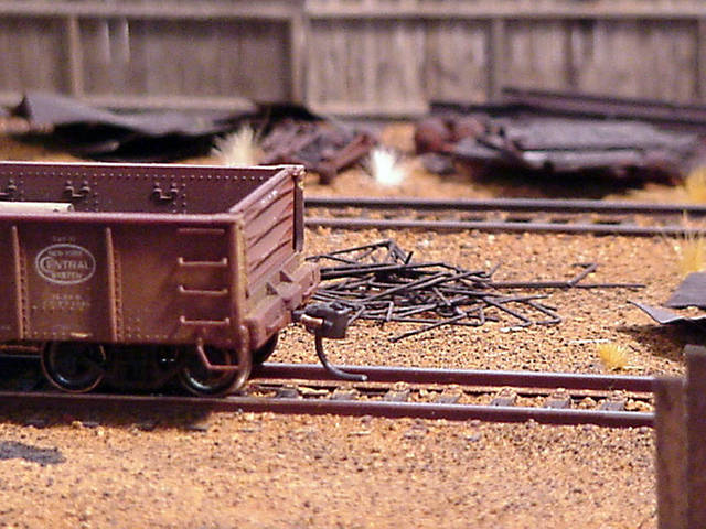

First pic is Krylon Camoflauge brown. Second is Rustoleum flat brown.
I like the look of the Rustoleum for older, less used track.
