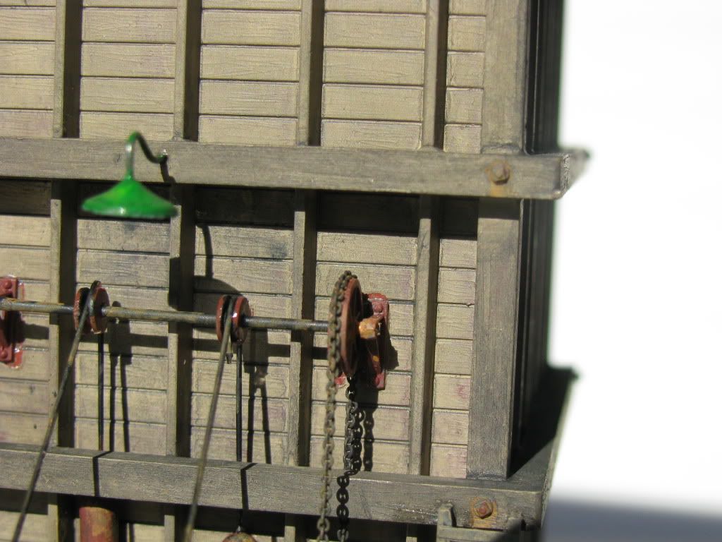

I put a base coat of PollyScale earth and then a wash of india ink/alcohol. If the plastic doesn’t have a grain to it, use sandpaper or a burnishing brush first. These photos are of a Life Like coal tower finished that way. I also use a spray can of Rustoleum Camaflouge as the base coat.
-Bob
Bob!
Excellent job on the coaling tower!!! The details are amazing and the paint work is superb!
Dave
Thanks Dave. I have built and sold over 30 of these on Ebay, each one just a little different in the details. This is one of the ways I support my hobby. This is the same coal tower that Cody Grivno built for the latest MR Rice Harbor layout, except he painted his a red/brown. It does make a nice model on the layout.
-Bob
