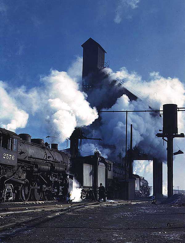

Class one roads were shopping steam until 1956, or even 1959 in the case of the IC. You’d always see a few filthy engines, especially around the end of winter, but you’d see as many shiny engines too. And even on absolutely filthy engines (see any photo of the Pennsy) there are still areas on steam that always remain BLACK and shiny.

Remember, the Depression wasn’t depressing because of the way things looked. With REALLY cheap labor around, and companies competing for every scrap of business it could find, America soon found out that it was more cost-effective to slap a coat of really cheap (and almost always white) paint onto something, making the company look clean, new and prosperous. George Sellios may be a first-rate craftsman, but he’s a fifth-rate historian.
I’ve got loads of photos of shiny & new 1930s rolling stock, and at least five photos of Depression-era wash racks, with people scrubbing off steam. Yes, things DID get dirty, but a little elbow grease and pride was far cheaper than abandonment.
