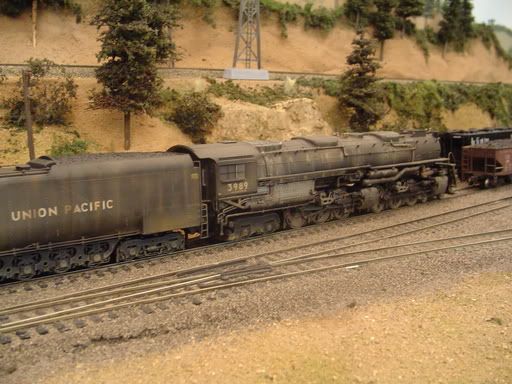

Hereis one of the one dirty Big Boy. Very rare to see a loco this dirty, as orsonroy pointed out:
